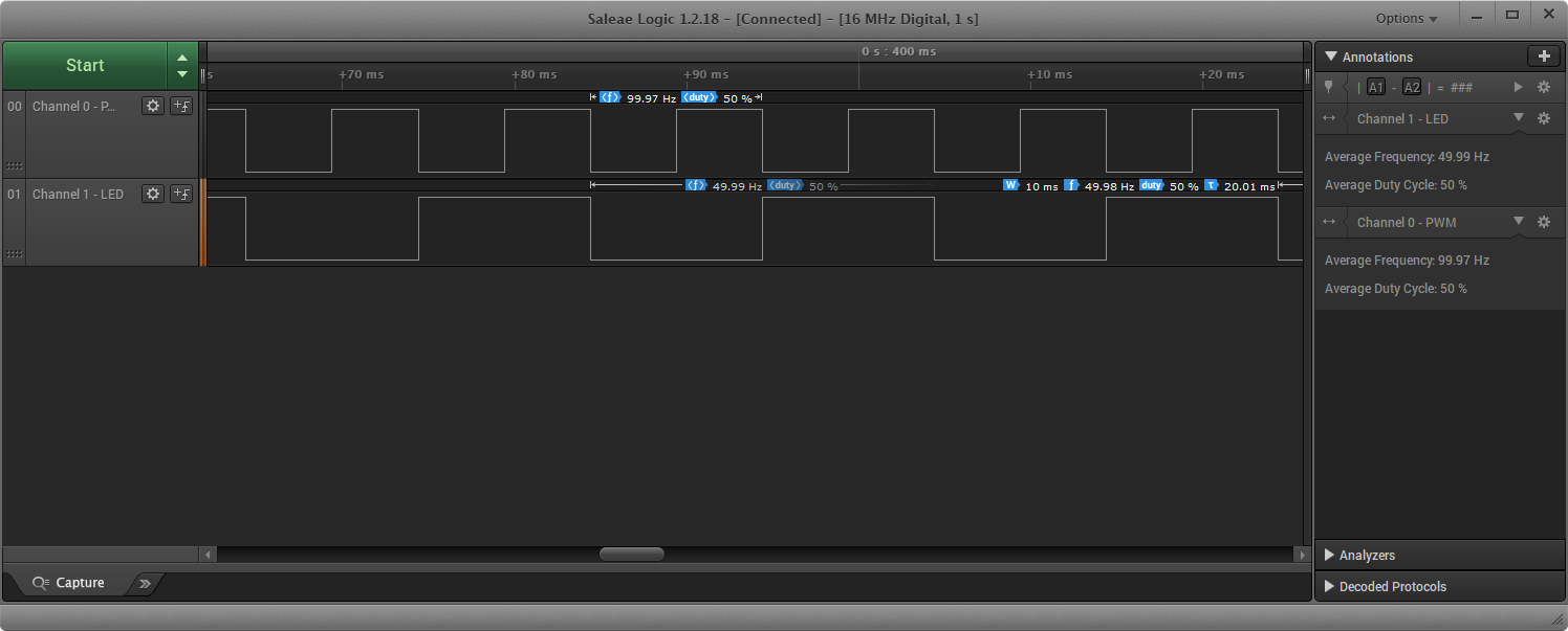

Posts: 1946
Re: Interrupt FALLING not working as excepted
I've tested this sketch on my BP:
const byte ledPin = LED_BUILTIN;
const byte interruptPin = PA6;
volatile byte state = LOW;
  pinMode(ledPin, OUTPUT);
  pinMode(interruptPin, INPUT_PULLUP);
  attachInterrupt(digitalPinToInterrupt(interruptPin), blink, FALLING);
  // Instantiate HardwareTimer object. Thanks to 'new' instantiation, HardwareTimer is not destructed when setup() function is finished.
  HardwareTimer *MyTim = new HardwareTimer(TIM2);
  // Configure and start PWM
  MyTim->setPWM(1, PA0, 100, 50); // 100 Hertz, 50% dutycycle
  digitalWrite(ledPin, state);
void blink() {
  state = !state;
And there is no issue with FALLING, channel 0 is the PWM and 1 the LED:
Of course, I've tested RISING and CHANGE and result is as expected.
I think a potential issue in your sketch is that the start should be volatile.
