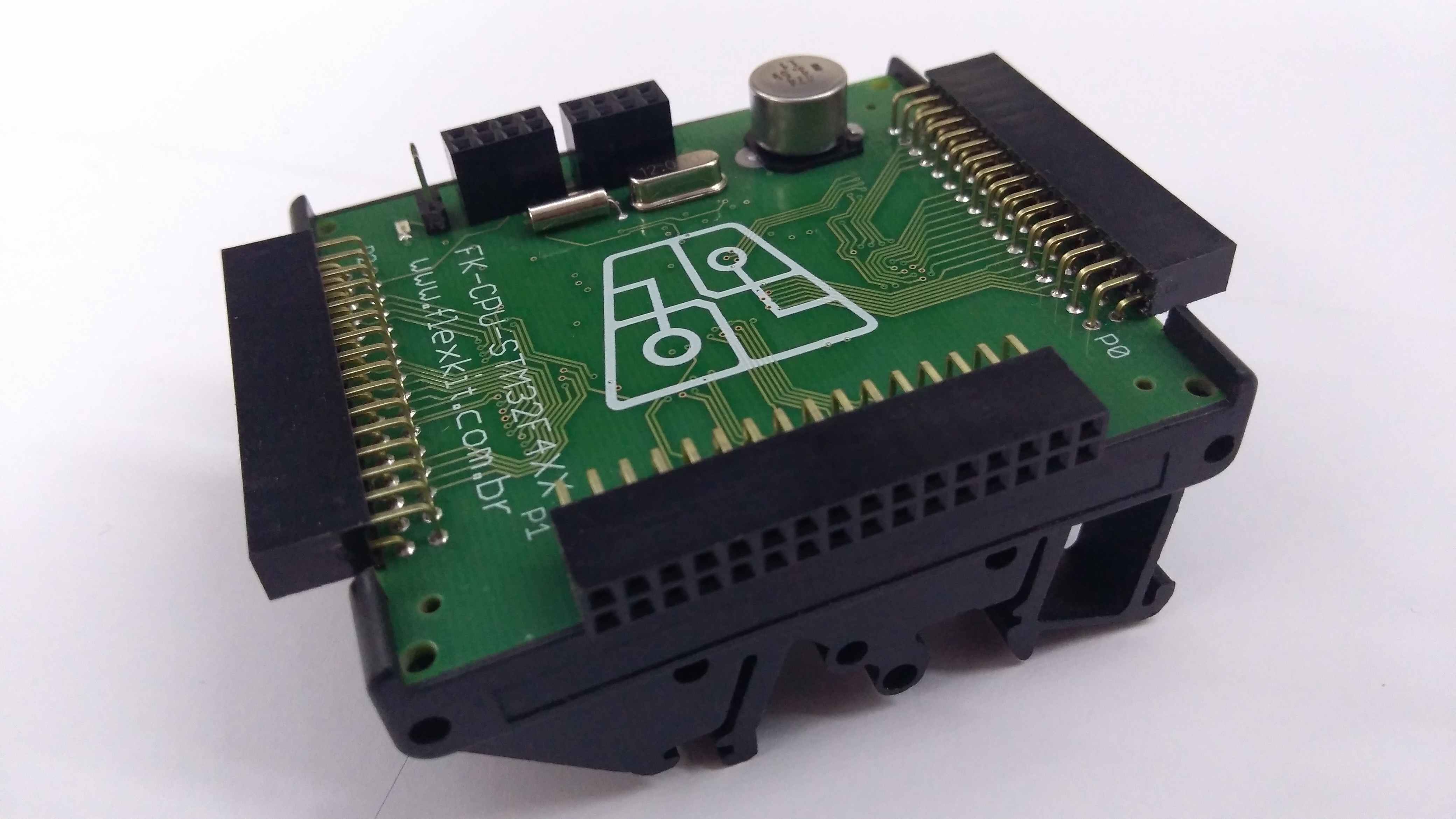

The company I work for has a custom STM32F405 board:
Which following the add a new variant Wiki I managed to get worked successfully. Therefore I would like to know how we can add our board to the support boards list https://github.com/stm32duino/Arduino_C ... /README.md then it will be configured automatically in Arduino IDE as well as the other manufactures listed.
Thanks in advance for the clarification
