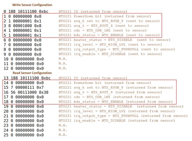

Quick update: to me it seems that the HTS221, although communicating over i2c, is not properly storing the configuration I send it. Here is an example showing the configuration I send to the sensor using the stm32duino HTS221 API and what I get from the sensor (again, using the HTS221 API to access the config). I've highlighted the parameters I'm specifically trying to change and what their values are after I transmit the change.
