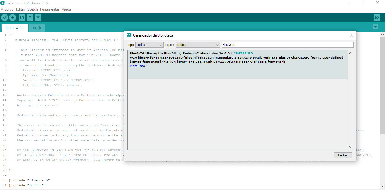

Hey guys, BlueVGA is officially published as an Arduino Library!
I hope it is usefull for some of you! :D
