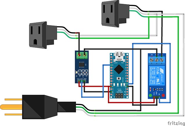

I'm attaching a schematic of the circuit, pretty simple and straightforward. It is in fact an Arduino relay, it is triggered by GND signal but in the code you can change that, also when wiring you can set it to NO or NC, so I guess you choose whatever combination of parameters to get the results you want.

As to your relay board - those are activated by low signal and it cannot be changed. Those have PNP transistors or optocouplers hardwired to Vcc, and you activate them providing GND.
As to those NO/NC outputs - those are 2 outputs from switching relay (SPDT - Single Pole Double Throw), which means that it has one input and 2 outputs, that you can switch between or use it as a SPST relay that only switches power on, or only switches power off.
I hate those boards, especially for use with Arduino (all boards type, AVR, SAMD, STM32, etc) and high current or high voltage operations. It's because when you set pin to work in digital output mode, it's by default set to LOW state, and this activates relay. You have to set this pin to HIGH state and it takes time (most ppl use digitalWire() which is really slow and they forget to do this in setup() ).
This means that for some short time relay is on and before every thing is checked, your machine is on, even when it's not safe to turn it on.
