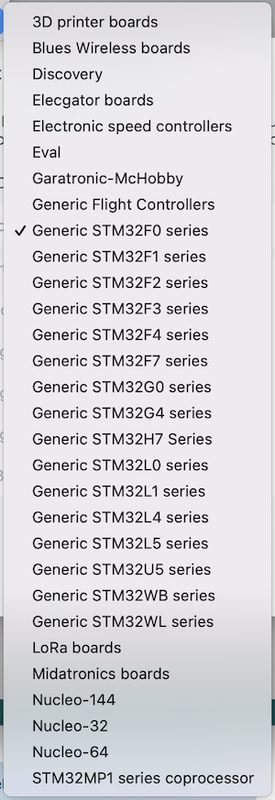

With "STM32 MCU based boards" chosen, the boards available are these:
I see in Windows that under Tools a "Board part number" can be selected to specify BluePill F103C8. However, on the Mac I'm not seeing a Tools > Board part number menu item, nor any other way to narrow down the board type beyond the series level.

You previously mentioned choosing "Generic STM32F0 series" as the board type.
I'm not sure if you subsequently realised that was wrong, because your latest image still shows the same incorrect selection. You will not be able to select Blue Pill until you change that (which, presumably you must have done at some point on the Windows system).
However that does not explain the "Board part number" menu item being missing under Tools >. Are any of the other STM32-specific menu items missing? Maybe you should show us what Tools > looks like.

ozcar wrote: Fri Sep 23, 2022 6:10 am You previously mentioned choosing "Generic STM32F0 series" as the board type. I'm not sure if you subsequently realised that was wrong, because your latest image still shows the same incorrect selection. You will not be able to select Blue Pill until you change that (which, presumably you must have done at some point on the Windows system).
Thanks for pointing that out. I just changed that to "Generic STM32F1 series," and the Blink sketch now compiles, uploads, and runs.

ozcar wrote: Fri Sep 23, 2022 7:36 pm As for Tools> Board part number, for whatever reason, the items are in a different order to what I have seen on Windows and Linux Mint with Arduino IDE 1.8.x, but "Board part number " is there in the image you showed??? Or does that not work?
Well, I really have to apologize again. When I was initially opening it, the Tools menu only included these items:
I guess I was working too fast and neglected to notice that, after the board series was selected, the Tools menu lengthened including a "Board part number" entry a number of items lower on the menu. That enabled selection of "Generic F103C8Tx" as the more specific board type.
I don't know how it works on Windows, but each time I start Arduino IDE with the board attached I need to manually choose "Generic STM32F1 series" before proceeding. Once I do that, it does appear that the more specific type (Generic F103C8Tx) is saved.
