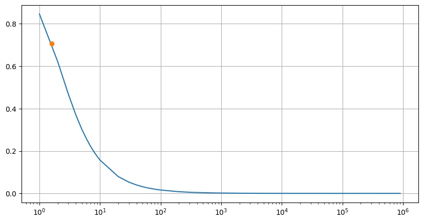

bode plot 10uF 10k
bode plot 10uF 10k
bode plot 10uF 10k
-3 db at 1.59 hz

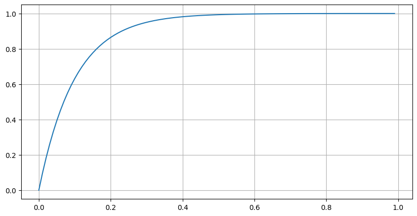

step response
step response 10uF 10k
This assumes the 'input' resistance is 10k, for NTC i'd guess at warmer temperatures it'd be ok.

Originally, i'm concerned with rapid temperature changes and that too large a RC constant will cause the ADC to read the delayed image rather than the instantaneous temperature. This is a concern when the temperatures is changing fast.
i.e. temperatures will overshoot, by which time it is measured, the actual temperature is (much) higher or lower
However, it seemed with these analysis that it may still work given the bode plots here.
Hence, a larger RC value could be tried if it can approach these bode plots, and graphs, i.e. if the worse delay in response is a fraction of a second
