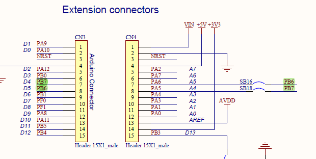

I need to connect 2 i2c device on my board and the pinout of the board show me that he as i2c on pin PA_9/PA_10 and PB_7/PB_6, but when i do the i2c scanner only the second one recognize the i2c, why? It's normal that only one i2c works or I'm doing something wrong?

If it is a nucleo32 check the schematic. I guess you have some SB to rework.

I talk about Soldier Bridge. Read the user manual or the schematic of the bord to see if pins you used are correct.

About pins and schematics with SB:
As you can see PB6/PB7 are available twice due to SB configurations.
