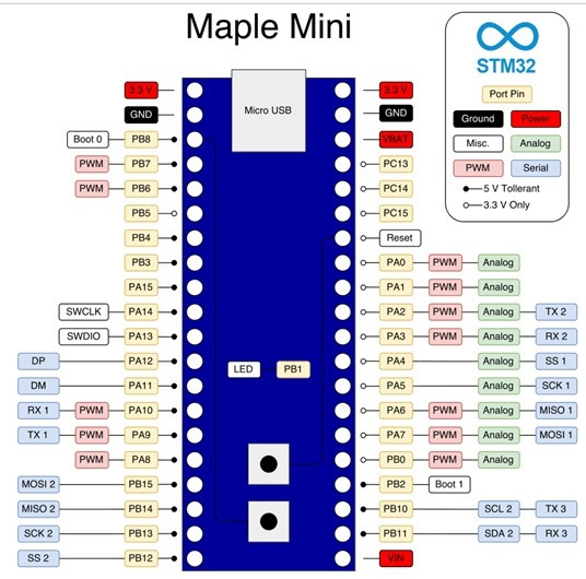

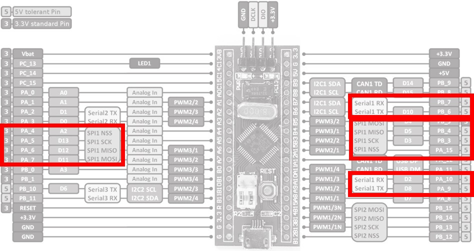

hello. Nice to meet you. If you look at the picture, it is marked 'PWM' in 'PB_4'.
I tried driving it, but the PWM doesn't work. What's the reason?

STM32C8T6 has only 3 timers with each 4 capture compare channels , so you can only get 12 pwm outputs a time
Re: 'STM32F103C8T6' not work PWM Function.
3 general purpose timer (each with 4 channels) + 1 advanced timer (with 4 channels + 3 compl. channels).
