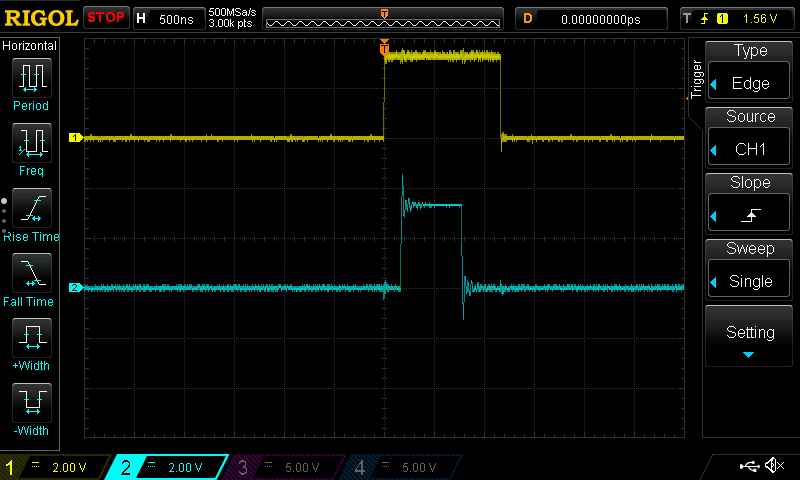

I got to do another test to see what sort of delay you would get going directly into your ISR instead of going via the attachInterrupt callback. To do this all I did was set a GPIO pin high in the stm32duino ISR, and with my attachInterrutp callback still in place, set the same GPIO pin low again.
So this is what I got (on H503, 250MHz):
The top trace is the pin the interrupt was set on ("RISING"), and the lower trace is the GPIO set high first thing in the actual ISR, and low first thing in my callback. From that the ISR was entered around 160ns after the interrupt pin went high, so there might be some hope for you.
Actually, from that you can see from when the bottom trace goes low, that my callback was entered just under 800ns after the rising edge on the interrupt pin, which is less than I saw in my first test. The reason for that is that I changed from using digitalWriteFast() for flipping the diagnostic GPIO pin, to using GPIOB->BSRR = GPIO_BSRR_BS8 and GPIOB->BSRR = GPIO_BSRR_BR8. I didn't look to see what digitalWriteFast() does, but it looks like at this level it does not take much to make or break things.

ozcar wrote: Tue Jul 08, 2025 10:03 pm I got to do another test to see what sort of delay you would get going directly into your ISR instead of going via the attachInterrupt callback. To do this all I did was set a GPIO pin high in the stm32duino ISR, and with my attachInterrutp callback still in place, set the same GPIO pin low again.
So this is what I got (on H503, 250MHz)...
I want to make sure I understand this: The directly-invoked ISR fired after roughly 160ns, and the attach-interrupt-invoked ISR fired after 800ns?
Yes, that is about it, the stm32duino-provided ISR (EXTI8_IRQHandler() for the pin I was using) got control after 160ns, and my attachInterrupt routine after 7??ns. What it does to account for the say 600ns difference, I don't know. Well, it has to be HAL_GPIO_EXTI_IRQHandler() processing, as that is all that EXTI8_IRQHandler() does, but I did not delve into the HAL code.
BTW, the fall of the interrupt line (top trace) would be a rough indication of the time for the interrupt to complete (so, including the "tail end"). That is because the test signal, if you want to call it that, was generated by the mainline code (two GPIOs tied together), and that was set low again when the mainline got control back after the interrupt processing.
