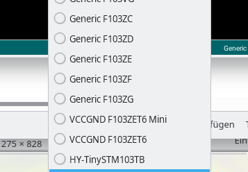

Re: SerialUSB doesn't work on Maple Mini and Bootloader2.0
Now it works without a workaround
I had select the Board part number: Gerneric F103CB
because with my screenresolution 1920 * 1080 I have not seen the maple Mini entry, because there is no scroll arrow below.
With the maple Mini entry it works
