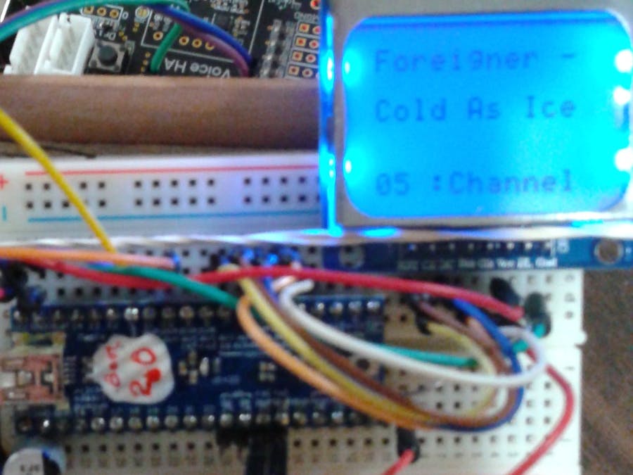

i think ray like the 'nokia' ones
https://www.aliexpress.com/wholesale?ca ... t=5110+lcd
smaller less resolution, just plain grey lcd and accordingly visible in plain daylight without backlight
extreme low battery consumption it runs on the old phones after all

i think i'd make my alarm clock out of a nokia one, my old radio clock the lcd got twisted so much it is fading out, the good thing about using a blue pill for a radio clock is that it can hookup with a esp8266 running at commands and time sync itself, and maybe add an additional lipo charger monitor to charge the phone
