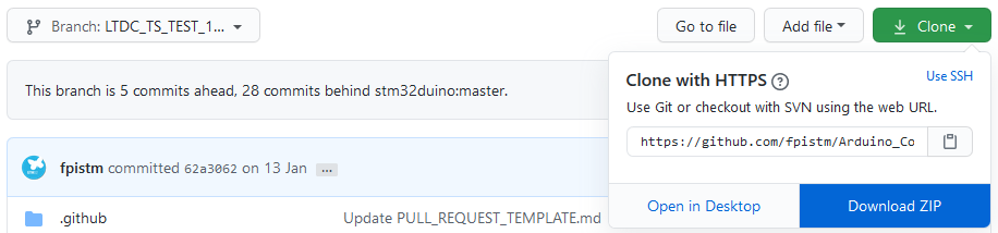

https://github.com/fpistm/Arduino_Core_ ... TEST_1.9.0
Then click on the down arrow of the "clone" button then select "download as zip":
Then unzip it where the core should be (where you deleted the 1.9.0)
Finally rename the folder (I guess it should be 'Arduino_Core_STM32-LTDC_TS_TEST_1.9.0') to "1.9.0".

That worked perfectly. Thanks very much!!
