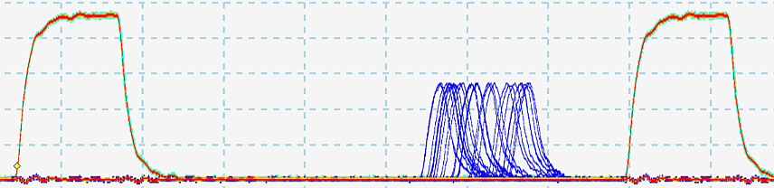

OK, I decided that I should put the codes used up here and while knocking the grammar into shape I decided to move the Nano pulses a bit further apart….
It looks as if the ‘Early’ pulses were actually very late ones. Oops sorry.
DRFDWF V2.png (72.67 KiB) Viewed 2470 times
