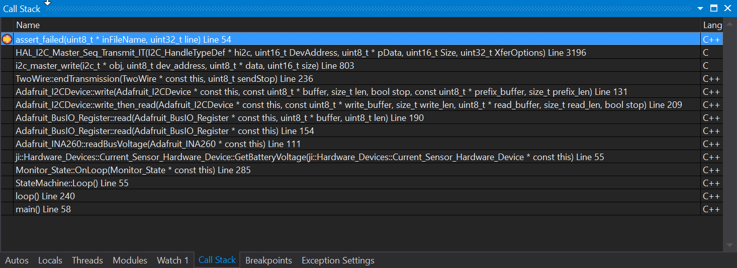

Here's an attached stack trace. It's almost like some sort of memory leak, it only occurs if the program has been running for a while?

You're way ahead of me. What makes you think this has anything to do with I2C getting stuck in busy state? When I had that problem, the busy state caused a HAL error code to be generated (after some timeout). I don't remember the details now, and I also don't know how that would surface when using STM32duino.
I can't match up the line number you originally mentioned, nor what is in your last post, but it has to be where it checks the transfer options?
assert_param(IS_I2C_TRANSFER_OPTIONS_REQUEST(XferOptions));
Does the ina260_test example run OK?

Hi, thanks for your help, The hal assert callback prints these locations.
stm32l4xx_hal_i2c.c line 3165
assert_param(IS_I2C_TRANSFER_OPTIONS_REQUEST(XFerOptions));
and
stm32l4xx_hal_i2c.c line 6428
assert_param(IS_TRANSFER_MODE(Mode));
