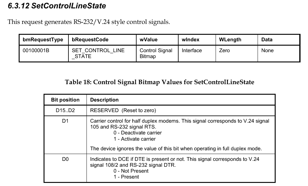

closely related to this is the topic of *flow control*
it turns out USB CDC ACM provides for DTE and RTS
but DSR and CTS is missing
that effectively makes it 'useless' for 'flow control' implementations

the DTR and RTS signals are rather 'commonly' (ab)used for some other things as they don't serve the original purpose of 'flow control'
e.g. in stm32loader, DTR and RTS 'signals' are used to toggle reset and boot0 for flashing firmware using internal uart boot loader
https://github.com/jsnyder/stm32loader
the use of DTR signal may create issues if say we want to make a usb-uart implementation where the DTR/RTS signals can be used for 'other' purpose
