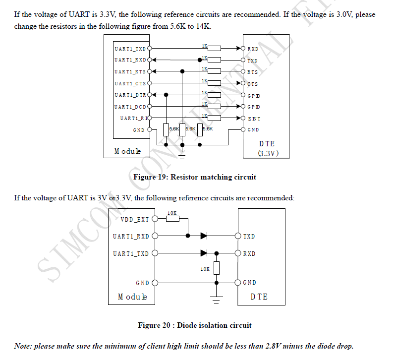

I have some problem with GSM SIM800C V2.
I don't know why but STM didn't send any data.
GSM work correctly (I check it using Arduino Duo. I call and everything works fine)
GPS and other stuff works fine.
Maybe some one can help me?
Core https://github.com/stm32duino/wiki/wiki/Getting-Started
The callnumber() function works fine.
I tested them on an Arduino Uno
The code I use.
    Board pinout what I use
    https://os.mbed.com/media/uploads/hudakz/stm32f407vet6_right01.png
    https://os.mbed.com/media/uploads/hudakz/stm32f407vet6_left02.png
    https://os.mbed.com/media/uploads/hudakz/stm32f407vet6_st-link03.png
    I found Original Schematic STM32F407VET6
    https://stm32-base.org/assets/pdf/boards/original-schematic-STM32F407VET6-STM32_F4VE_V2.0.pdf

by Orion1398 » Sun May 16, 2021 6:59 pm
Hi!
Everything works! :)
I use logic level converter, and try work whit SIM module using 5v logic.
TLL -> 5V
RX 3.3V (STM) -> LLC ->TX 5V (SIM)
TX 3.3V (STM) <- LLC <-RX 5V (SIM)
Most likely, there was a problem with TTL on the SIM module, and correctly work only 5V logic.
Thank you all very much, and I went to make a menu for that thing) :D

Datasheet what I found.
https://www.elecrow.com/download/SIM800 ... _V1.02.pdf
But I Cant find there V_TTL pin
I try use 3.3V to 5V Logic Level Converter and put to V_TTL 5V (now apply a 3.3 V іf use arduino 5V )
This is what it looks like

Posts: 1961
Re: STM32 F407VET6 SIM800C V2
Well based on the datasheet it seems Serial interface depending of voltage should be adapted:
One other option you should check is the flow control.
