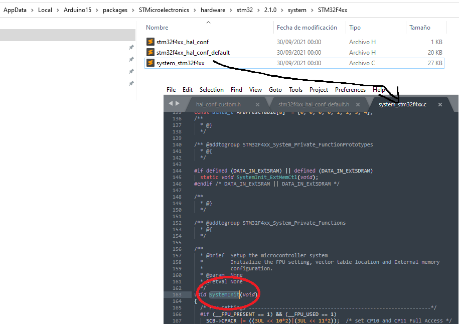

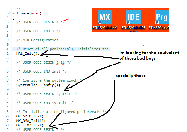

The only thing i wanted to know was what the hell is Arduino actually compiling when you press that green button. Aaand where to look for that code.
Because i want to be able to "port/merge" my cubeMX generated progects/library into arduino.
This gave me a overall clue of the process: https://arduino.github.io/arduino-cli/0 ... d-process/
This show me how is the startup hidden boilerplate code defined https://github.com/stm32duino/wiki/wiki ... figuration

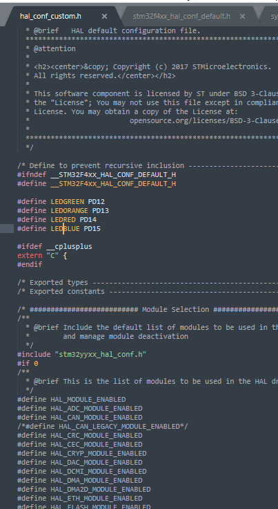

i know now thanks to you that all important clock and peripheral definitions can be overwritten by adding this file in the sketch folder:
But i still dont know what format or where is Arduino making those #defines effective
mx periph init2.png (32.33 KiB) Viewed 5269 times
Is arduino CLI calling this function?It looks important, and very startupy.

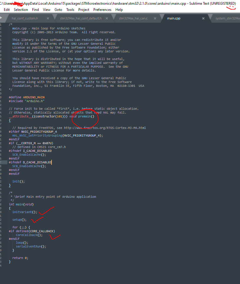

for all the rest you can look for codes in main() etc.
This has been mentioned before but i dont understand, where can i find that "main()"?

Yup im facing a limit right now, i just want to control what peripheral is initialiced and when, as i am able to do with STM32cubeMX
most of things that leverage the platform, e.g. hardware timers and the specific features do not conform to the arduino api and it is questionable if other mcus provide the same implementations of those pheriperials.
I want to make a DMA+PWM custom library for example, im only interested in a particular mcu

to find main() an easy way is to do a text search in the core
maybe codes you'd see is
void main() {
	setup();
	while(1)
		loop();
everything else is platform specific. and because of that, codes or 'libraries' would likely break when simply they are used on a different platform.

Jeeeesus that is exactly what i was looking for, sorry for all the fuzz.
Sometimes is hard to articulate what you dont understand yet.
Now i just need to look inside that premain()
I think i can work from here, thanks for your patience
