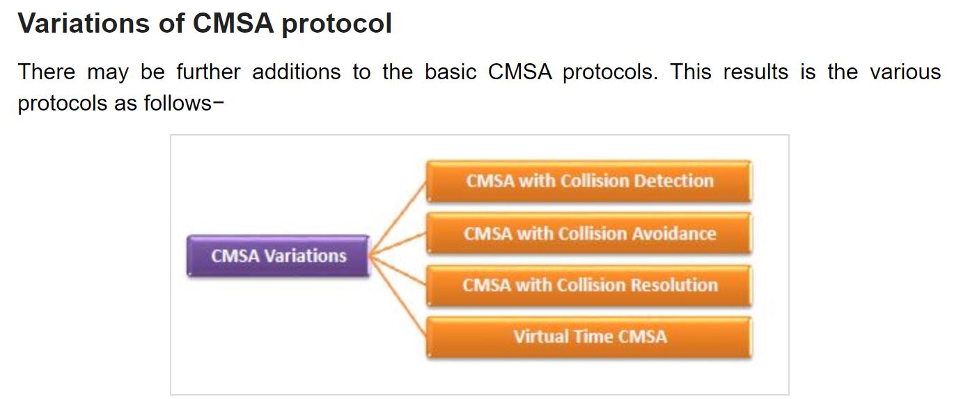

mebab wrote: Sat Nov 20, 2021 4:17 am ...
Having a CSMA protocol cannot prevent congestion issues as much as 100 %. For example, when the channel is free for all nodes and by chance, two nodes start to transmit simultaneously, in very rare situations, the received mixed signal of two nodes can be read like a normal one. This corrupts the original compressed data and causes failure while decompression.
I'm old and out-of-touch with many "modern colloquial expressions", but in my time I would have said simply, bummer!
CSMA Enh.JPG (74.37 KiB) Viewed 5599 times
I'm a TCP kind of guy and I need never worry about such issues.

Thanks Ray! I am really learning from you and appreciate that.
This is my experience using Carrier-sense multiple access (CSMA) in a Lora node-to-node communication:
Having a LoRa node in a single RX mode (not continuous) needs us to activate RX mode to check the channel to see if it is free. Then change the mode to TX for a transmission. Every mode change (RX-->TX) needs a short transition time before being able to transmit. In addition, nodes are located at different distances and we consider different times on air for each node. Then, in crowded networks, there is a rare chance that one or even more sensor node/s see also the same channel free and start to transmit during the mentioned variable periods.
My experiments show that: the received signal in the central LoRa node may be corrupted which is detectable with no extra effort. However, there is another very little probability where the center receives for example numeric data simultaneously from different sources (nodes) and mixes them. This was a root cause of a rare failure in my system when communicating without Acknowledgement (ACK).
