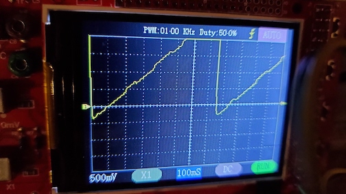

My program outputs a waveform read from a table, using PWM generated from TIM1 at 50 khz, filtered through a RC circuit (470 ohm resistor, 4.7 uf capacitor). There is a phase accumulator attached as an interrupt to hardware timer TIM2.

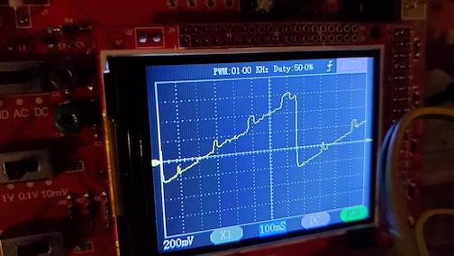

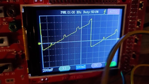

The waveform is producing unwanted spikes/teeth (see pictured), which is undesired. I tried messing with the RC circuit to see if it's a hardware issue, but the problem persists.
The spike happens consistently at a rate of ~250 milliseconds, regardless of the set frequency of the waveform (the frequency of the waveform, not the overflow).
Another characteristic of this spike is that it gets less pronounced as the signal is amplified in software, the spike itself smooths out and gets wider, though it's very much still there when no attenuation is applied. To see this, comment out the " * .25" in the capture compare function in the program loop.
Can someone take a look at my code and see if I'm making any rookie mistakes that may result in this issue? The code is adapted from the following Arduino project. https://note.com/solder_state/n/n4c600f2431c3
Thank you!

IMHO, code is ok, maybe DSO138 is messing with you (screen antialiasing). Switch to uS range and look how much voltage ripple it have.
Or maybe too high LP filter capacitor. It will distort your waveform from saw to triangle.
Or, Instead of 50000, try with 250000 pwm frequency.

Thank you for looking at my code! I think that it is a hardware issue after all. A mix between the oscilloscope and the actual testing platform that I'm having (dupont cables everywhere).
It's also good to hear that the code looks good for once :lol:
