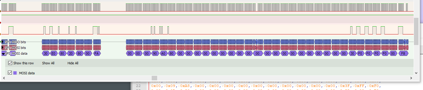

After playing with the logic analyzer, and a known image, there's no need to use someone else's code. Encoding is simple (simpler than SSD1306) : frames are made of two pages (top and bottom), themselves made of lines, with some command/control bytes that just have to be removed.
The datasheet is a useless crap, making simple things overcomplicated.
Frames are fixed size, except at initialization time.
Frame = two pages ; begins with one byte
Page = 32 lines
Line : prefix = 7 bytes, then the pixels (32 bytes), postfix = 1 (ot 2?) byte -> 40 bytyes
2 bytes when one would be enough.
Should be easier to decode (SSD1306 needed "sub-matrices" transpositions)
Page = 32 lines
download/file.php?mode=view&id=761
- Capture.PNG (90.75 KiB) Viewed 6293 times
