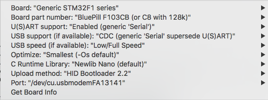

A while back I started a small project using a BluePill and a NEO-6M GPS module to display info on two SSD1306 I2C displays.
I connected the GPS module to the Serial2 hardware serial port of the BP. I am using the Official Core 2.0.0. and the TinyGPSPlus library
My Arduino settings are as follows:
I have attached a small test program to get the data from the GPS and display it on one I2C display and the serial port, just a quick and dirty working example. ;)
