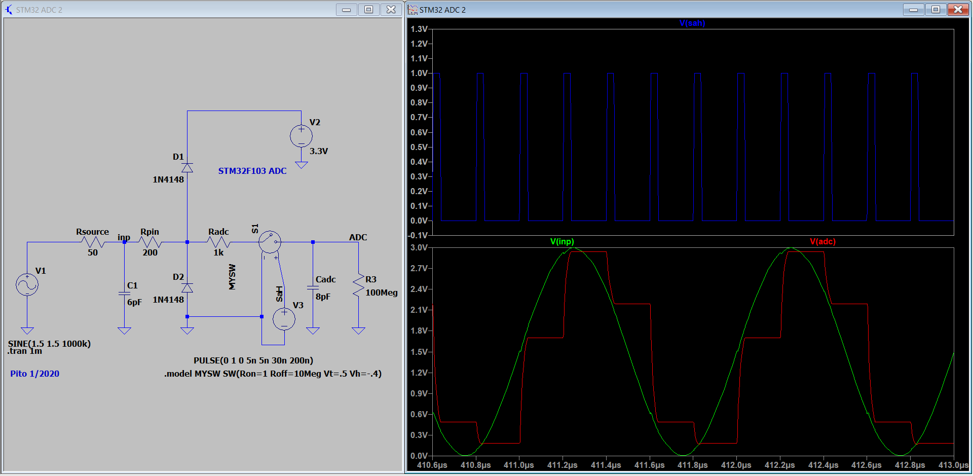

Below is a simulation of the input circuitry and Sample and Hold of STM32F103 ADC.
Radc is 1k and Cadc is 8pF (Datasheet).
C1 is a parasitic capacity of the input pin and wiring.
Diodes and 200ohm resistor -> simplified PIN protection wiring inside the chip.

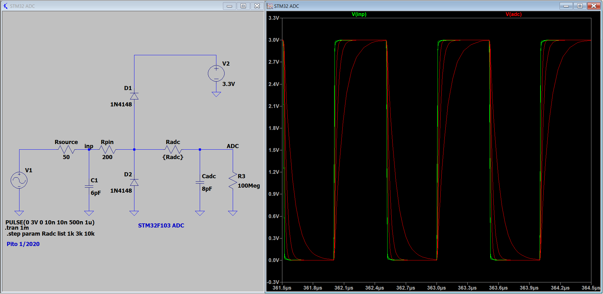

1. First picture is how the edges look like at the Cadc for Radc=1k 3k 10k.
It only shows the BW of the input circuitry.
For 1k it looks good.
The Sample and Hold is opened for a small fraction of the sampling period only, say 30ns at 5Ms/s. During this time the Cadc must charge/discharge itself via the resistors such the voltage at Cadc always follows the input voltage (it means at the end of the S&H the voltage at Cads should be as close as possible to the actual input voltage).
2. Next is the 1MHz sine 3Vpp input, ADC 5Msamples/s, Sample and Hold is opened for 30ns, sampling period 200ns.
It looks pretty good for "1MHz sine". The error could be something like 3% full scale max.
Of course, for full 3.3V squared input the Sample and Hold must be able to charge/discharge the Cadc within 30ns from 0 to 3.3V and vice versa, worst case.

- STM32 ADC input and SandH.PNG (78.98 KiB) Viewed 4214 times
- STM32 ADC input and SandH 2.PNG (73.19 KiB) Viewed 4214 times

Very good simulation pito. I think an error of 3% is accettable for my case.
Thank you for advices
