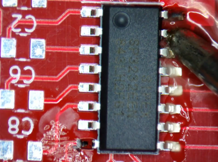

Here a short video I did a few years ago showing the complete soldering process (using a TS100 iron + BC2 tip):
https://www.youtube.com/watch?v=JlKLheYB8z0
The only "difficulty" is to align the IC to the pads at the beginning and solder the first two pins to block it (before completing the soldering with the "dragging" technique).
