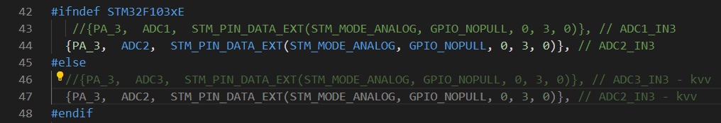

It seems that I've managed to find the problem with analogRead PA_3:
Annotation 2020-01-03 224859.png (29.14 KiB) Viewed 22590 times
There can be a mistake at line 32. Instead of #ifdef #ifndef is used. So in that case PA_3 refers to ADC3 with 3rd channel. But the rest of refers to ADC1 and ADC2. So, I've commented 46 and added 47 with ADC2. After that it started to work.
That is in file PeripheralPins.c from variant. Should I suggest this as a change for commit or better correct #ifndef to #ifdef?
