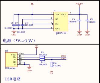

Next, while this works, it is not best practice:
Sensor, display and W5500 are powered from the 3.3V pin, and the blue pill is powered with 5V from the PC.
The BluePill has a 3.3V input and you benefit from not using the onboard 5V-3.3V regulator.
Just EXERCISE CARE if you continue to utilize the USB.
BluePill LDO.JPG (22.66 KiB) Viewed 7818 times

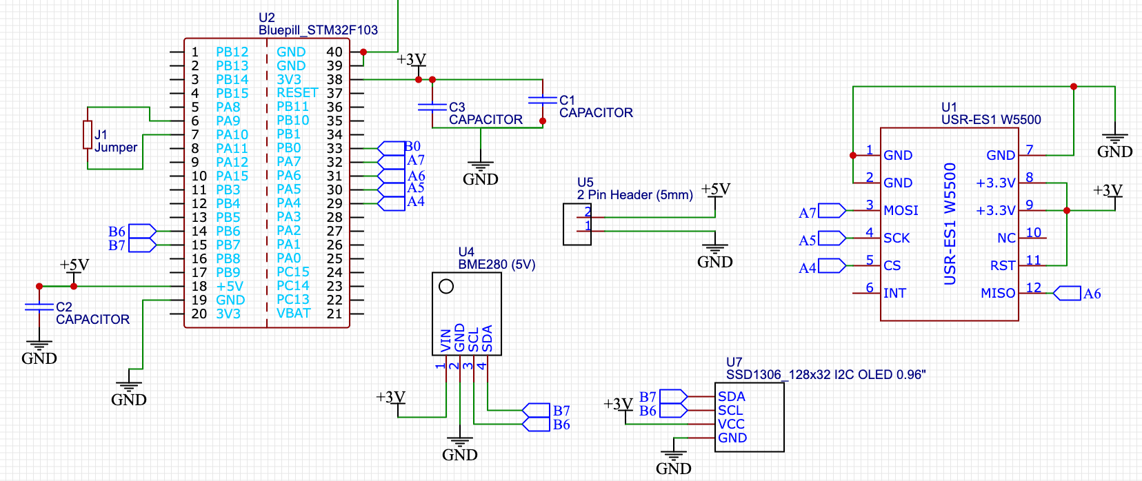

ag123, Im sorry but I dont get what do you want me to do.
mrburnette, I think it might not be the best idea as you said, to power things from STM32. As I have seen, ethernet module consumption could go till 200mA, display till 25mA and BM280 1mA. I would think that if there is not enough power, the ethernet module would not work, but it works, and there is not drop of voltage.
Well I just saw that RESET pin of the ethernet module is not connected to the stm32 so it might work if i can reset it, take the data, connect and then post. I will try next week when I will be able to unsolder the PCB. Despite of that, it is strange the behaviour of the sensor. I dont know if this approach could get the sensor to work.
I attach some of the schematic:
Captura de pantalla 2021-07-01 a las 17.26.38.png (55.52 KiB) Viewed 7814 times
And the look of the PCB: (DRIVE)
https://drive.google.com/drive/folders/ ... sp=sharing
