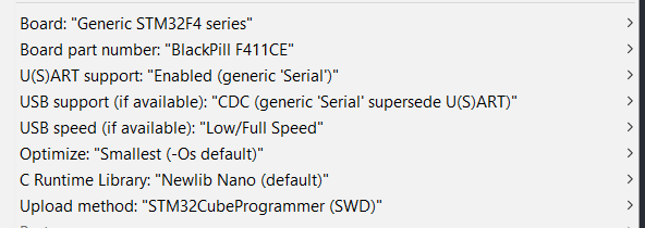

i use this settings for my code
Re: Cant use Serial.print in setup()
can you describe your issues?
what is the serial terminal/monitor that you are using?
did you try
Serial.println("hello world") instead?
did you manage to blink the led?
have you reviewed these links?
viewtopic.php?f=2&t=3
viewtopic.php?f=2&t=301
