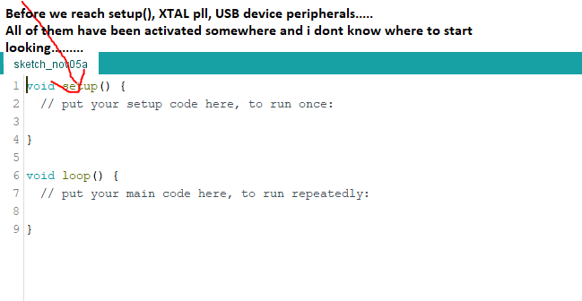

Electronics dark wizards i summon you!
I want to start developing(not just using) code with stm32duino. :!:
I do have some years experience using baremetal STM32 and i would love to port some of my libraries to work with stm32duino.
At the moment im lost i know nothing about the core architecture inside stm32duino.
I have no idea of what is happening under the hood or where to look for it.
I took a look at the github page (stm32 cores) and im nowhere closer to understand....
So any tips, pointers or advice? :ugeek:
Things initialised automatically before setup() by arduino that i know of :
  • HSE 8Mhz xtal and internal clocks
  • USB device if chosen in Tools/USB support:
