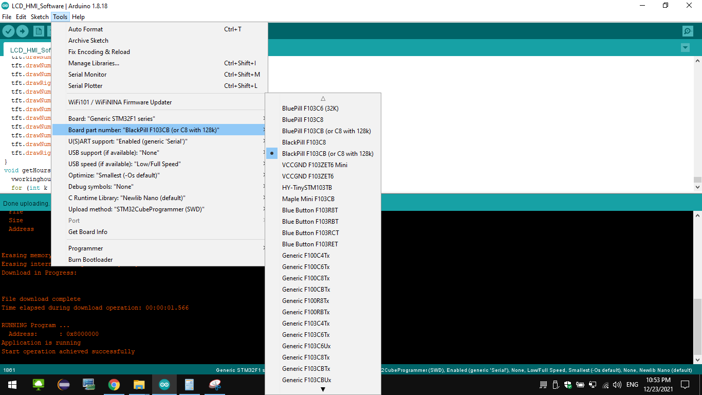

- Posts: 6
- Joined: Tue Dec 21, 2021 9:29 pm
Re: only 50% of program gets compiled!!!!
and this is my settings
- this is my settings
- SETTINGS.png (75.21 KiB) Viewed 5110 times
