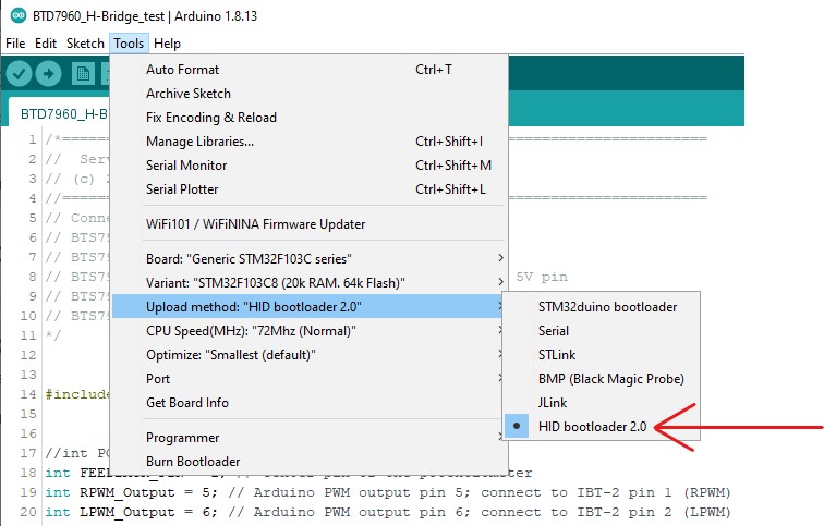

Hello I sudo Linux, Zorin OS distribution Based on Ubuntu 20.04 LTS.
I can upload code using the FTDI (programmer) adapter.
My STM32 is a bluepill clone F103C8;
I want to use the stm32's own USB;
I can write hid_generic_pc13.bin (low_and_medium_density) using Cube Programer by ST.
Using Linux command "dmesg" appears:
[ 9612.555238] hid-generic 0003:1209:BEBA.0005: hiddev0,hidraw3: USB HID v1.11 Device [www.serasidis.gr STM32F HID Bootloader] on usb-0000:00:14.0-2.2/input0
But the Arduino IDE doesn't find the port;
I don't know what else to do, I've tried several tutorials blog articles ...
I don't understand this installation manual, in the section for Linux: https://github.com/Serasidis/STM32_HID_Bootloader
is there any other way to program a stm32duino with its own usb without using the generic hid bootloader?

Hello utherbone,
Did you set the upload method ?
