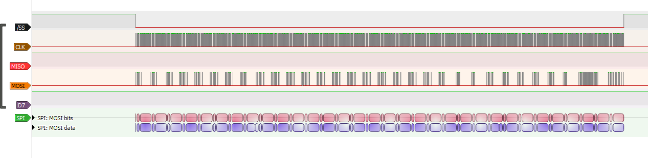

Here's a picture of the SPI data (WITH THE CD40106 HACK !) :
download/file.php?mode=view&id=762
