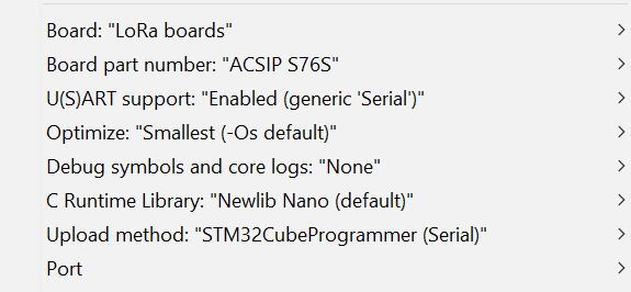

I am trying to integrate the device in the cloud( The Things Industries). Have put the necessary fields such as Deveui, Appeui and Appkey and have uploaded the code in ACSIP Module.
In addition, I don't see anything in serial monitor of Arduino IDE as I use the example code in MCCI Arduino Lorawan - Simple Sensor BME280.
What should I do to connect the device in the cloud and display sensor data in serial monitor? :?

The result as I uploaded the code:
Posts: 1945
Re: ACSIP_MCCI Arduino Lorawan
Your main issue is that the board is not properly flashed as stated in the log: 'Error: failed to download the file"
You have to ensure you start properly in bootloader mode.
As said I could not test as I do not have this hardware. Anyway, it should work.
Refer to the https://www.st.com/resource/en/applicat ... ronics.pdf
to properly enter in this mode.

@urqwerty did you set boot0 and press reset ?

Already set the boot zero and able to upload the code properly. But seems the code still not working.
Still not able to integrate the device to the The Things Industries Cloud. :?
