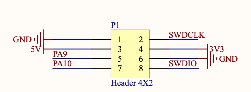

my board is stm32f401cc,and IDE is PlatformIO in vscode.
When I build and upload the code (via serial port), I open the monitor with serial port but can't see any data, thanks for your help

Posts: 504
Re: cant open the stm32f401cc serial terminal
What are your board settings ??
As Serial might be USB Serial, not UART.

hi,thanks.my board setting is UART.
Posts: 504
UART what ??
