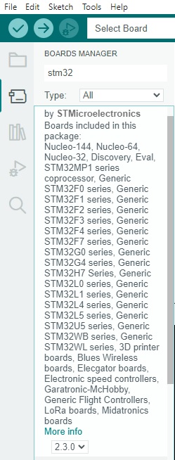

I managed to get the boards to install in the Arduino IDE 2.0.2 on one of my computers following this post: https://microcontrollerslab.com/stm32-n ... -tutorial/
My second attempt on my other computer following the same post got to a point where it allowed me to see the boards package but there is no install button to install the package.
I wiped the Arduino 2.0.2 and reinstalled only to get the same thing.
Board issue 1.jpg (69 KiB) Viewed 6125 times

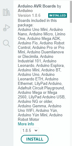

On my first computer there was an install button in the lower part of the screen shot above like as shown for the arduino avr boards in the screen shot below.
Board 2.jpg (49.52 KiB) Viewed 6125 times
I just clicked the install button and it installed the package and the STM32 boards were available for picking out of the board manager.
Any thoughts on what I'm doing wrong would be appreciated.

by fpiSTM » Tue Nov 29, 2022 5:27 am
I got this and simply resize the board manager subwindows

Re: Arduino IDE 2.0 and STM Board Installation Package
Post by kstuck »
Thank you!
That worked.
I didn't even know that was a thing.
In case others have the same issue here is what I did:
In the file preferences is set the interface scale to 80%
Then the install button showed up
