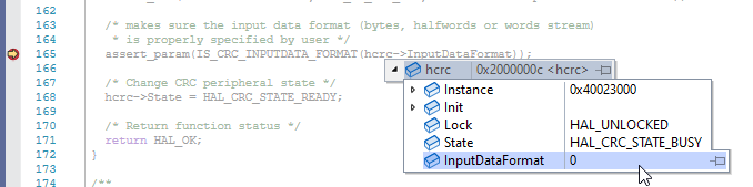

m trying to get an stm32l452re running but when i try to run my program, it fails at line 165 in stm32l4xx_hal_crc.c:
  /* makes sure the input data format (bytes, halfwords or words stream)
   * is properly specified by user */
  assert_param(IS_CRC_INPUTDATA_FORMAT(hcrc->InputDataFormat));
When called from line 70 in "hw_config.c":
  /* Initialize the CRC */
#if defined(HAL_CRC_MODULE_ENABLED)
  HAL_CRC_Init(&hcrc);
#endif
I'
How do i set it up so that hcrc is setup properly? Thanks!

I guess, You got this issue because you enabled the ASSERT.
As the handle hcrc does not init explicitly this field it is set to 0 which is not a correct value.
I've made a PR:
https://github.com/stm32duino/Arduino_C ... /pull/1941

fpiSTM wrote: Fri Feb 03, 2023 2:08 pm I guess, You got this issue because you enabled the ASSERT.
I've made a PR:
This PR fixed the issue
