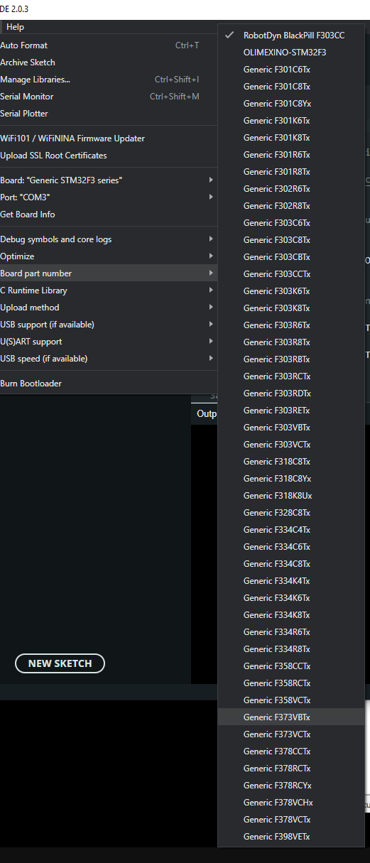

Re: Adding STM32F373VCT to STM32 variants for ArduinoIDE
Well, I do not advice to modify the folder as they are generated automatically. Simply add the linker script and a default generic clock config in the folder STM32F3xx/F373V(8-B-C)(H-T)
I've simply added the board entry of the STM32V373V in the boards.txt and it appears properly:
