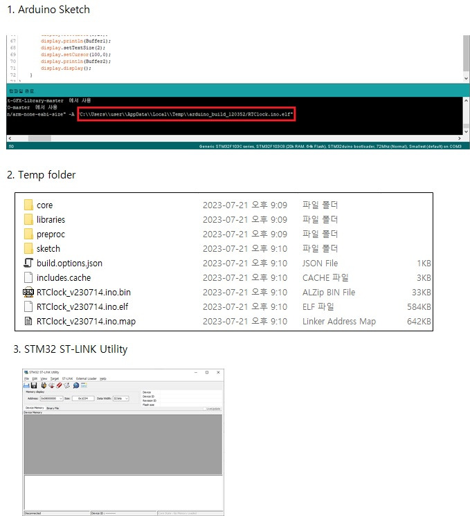

What I want to do now is:
1. Can I put the 'STM32F103C8T6' firmware without giving the Arduino Sketch source code?
2. It was found that '.bin' and 'elf' files were created through Arduino sketch.
3. Can I create a 'hex' file through 'Arduino Sketch'?
4. Also, if I created a 'hex' file, how should I put the 'firmware'?
5. Can I put it through 'STM32 ST-LINK' program?
If you know, please help.

1. Open 'STM32 ST-LINK Utility'.
2. Connect the target.
3. After clicking the program 'verify'
4. I put the '.bin' file created in the Arduino sketch.
'bin file download url : https://drive.google.com/file/d/1dWZzM7 ... drive_link
5. But it doesn't work.
What's the reason?
