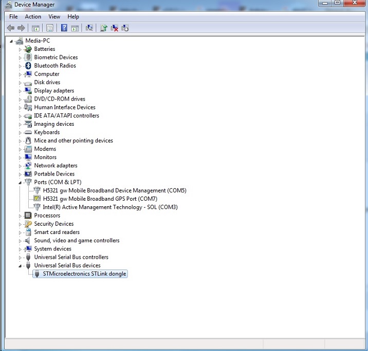

This is with the STLink plugged in

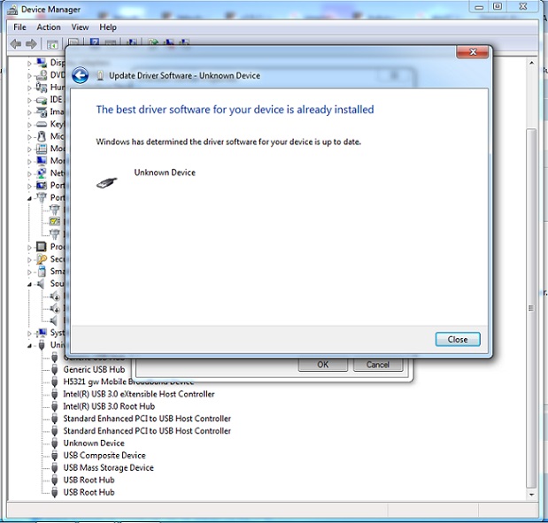

This is with the STM32 onboard USB plugged in and the STM32 put into DFU Bootloader mode. If I take it out of bootloader mode by pressing reset the device disappears completely from Device Manager.

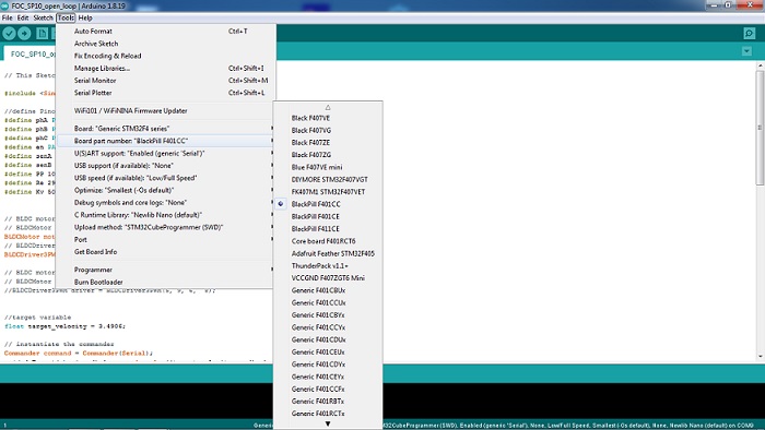

I've changed the board to Blackpill STM32401CC and loaded the script again and still no serial port available in Windows Device Manager.
I'm not experienced at coding so I'm not sure what the link is about. Do I copy that into the Arduino IDE and load it??

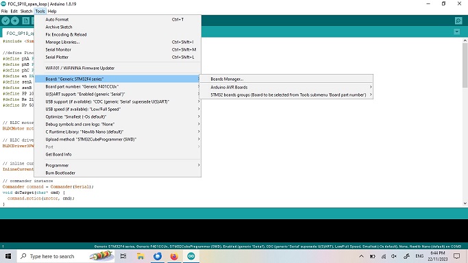

BlackPill F401CC is for boards with 25MHz crystal
Generic F401CCUx is for boards with 8MHz crystal
You must select "USB support->CDC (generic Serial supersede U(S)ART)" from menu or "Serial" will on serial port (PA9/PA10), not as recognizable USB device.

warjon
Posts: 5
Joined: Tue Nov 21, 2023 11:04 pm
Re: STM32F401CCU Black Pill not detected by Win 7
Post by warjon »
Bakisha wrote: Thu Nov 23, 2023 2:23 pm BlackPill F401CC is for boards with 25MHz crystal
If you still can't see port in device manager, try deleting driver, and click "scan for hardware change" from device manager.
While in device manager, click "view->show hidden devices" and uninstall all unknown devices.
Or try different USB ports (front/back) on PC.
Or try different USB cable.
Check if 3.3V regulator is working. It is recommended that when powering from both USB and ST-LINK to use only GND/SWSCK/SWDIO, and not 3.3V connected.
Thank you to all that have assisted me in getting this working.
This last post solved the issue and I now have upload capability via STLink and Serial communications via USB so I can tune the PID. thanks again Warren
