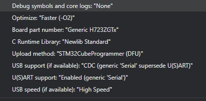

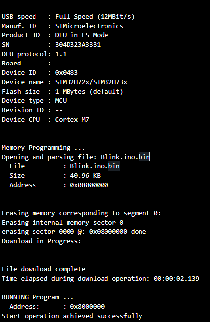

I seem to be able to upload a basic sketch using DFU mode after also installing "STM32CubeProgrammer v2.15.0"
Screenshot 2024-01-26 184142.png (38.03 KiB) Viewed 12866 times
However after upload the serial line no longer connects, the pin doesn't blink either.
I can get back to DFU mode but can't seem to get the serial to come back.
I am trying to figure out the proper settings for uploading. Any suggestions appreaciated!

SKR 3 uses 25MHz external oscillator, generic H723 is defined with internal oscillator, you might need to define new board variant:
https://github.com/stm32duino/Arduino_C ... 28board%29
or redefine SystemClock_Config(void)
Also, I think that HS USB needs external PHY that is absent in SKR 3.
