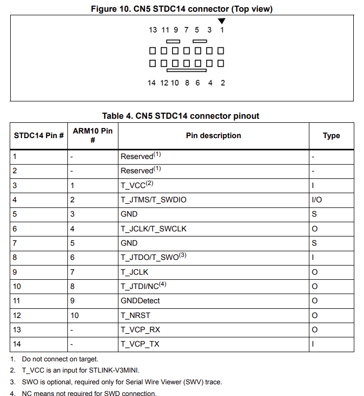

I have a STM32 F405 Feather Express board that I can't seem to connect to read Serial properly and receive Serial output from the board through Arduino when I know the program has been uploaded correctly and the program is running. I'm trying to explore using SWO instead using an STLink V3 MINIE but I can't figure out how to connect the SWO pin. Would anyone be able to explain the hardware connections?
- STLink Connections.png (88.47 KiB) Viewed 2579 times

You need SWCLK and SWDIO.
https://learn.adafruit.com/adafruit-stm ... /downloads
So you know, wher connect GND, SWCLK and SWDIO.
Here you can see schematic:SWD Port
On the bottom there is also a 2x5 connector pad that can be used to connect an SWD debug port for advanced uses. We don't solder the connector in place because it would take up space and make it hard to insert into a breadboard. However, you can pick up a 2x5 connector and solder it yourself! Pinout matches any/all JLink/SWD programmers with 2x5 connectors.
