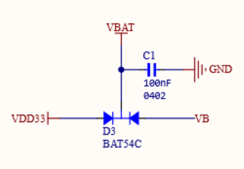

Value of VBAT is wrong!
I connected a mignon cell between VB-pin and GND-pin of board. It should be the VBAT-pin. Even without a cell in battery holder, sketch returns 1,09 V.
This is the part of schematic:
RTC circuit.png (46.1 KiB) Viewed 4183 times
So measuring of VBAT is useless.
But sketch should show VCC.
Is there a bug not taking care about voltage divider? 1,09 * 3 would make sense ..
