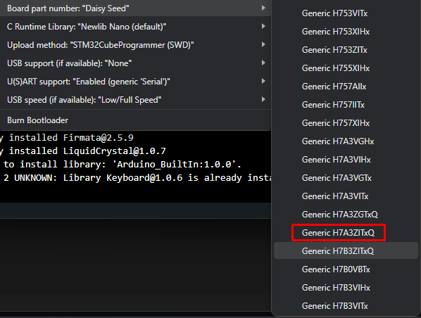

What is the source of the drop down list for the available generic cards?
I looked where (I believe is) the configuration files:
AppData\Local\Arduino15\packages\STMicroelectronics\hardware\stm32\2.9.0\variants\STM32H7xx
And I see more folders for 7A than there are in the list. Actualy I see a folder H7A3Z(G-I)TxQ_H7B3ZITxQ but there is no 7A3Z in the drop down list.

byquip
Posts: 11
Joined: Thu Jan 09, 2025 10:50 am
Re: NUCLEO-H7A3ZI-Q Code loads but does not run
Post by byquip »
Hello,
I have same board to work with and I tried to add it myself using the guide fpiSTM mentioned.
The problem is that H7A3ZITxQ did not appear in the list of Board part number after I add 3 boards from H7A3Z(G-I)TxQ_H7B3ZITxQ/boards_entry.txt to boards.txt.
I possibly missed something but I dont see why they didn't appear.
Posts: 1961
This is a know issue of Arduino IDE 2, you have to clean the cache:
https://github.com/arduino/arduino-ide/ ... 1152005617
byquip
Posts: 11
Post by byquip »
Thank you for the hint.
Removing arduino-ide folder from AppData helps BUT after all the changes and before close IDE need to remove link from Preferences
https://raw.githubusercontent.com/stm32 ... index.json
If not then all changes will be overwritten.
