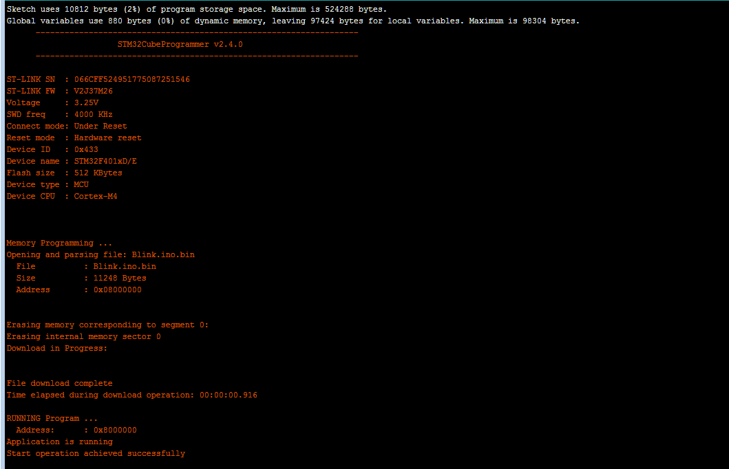

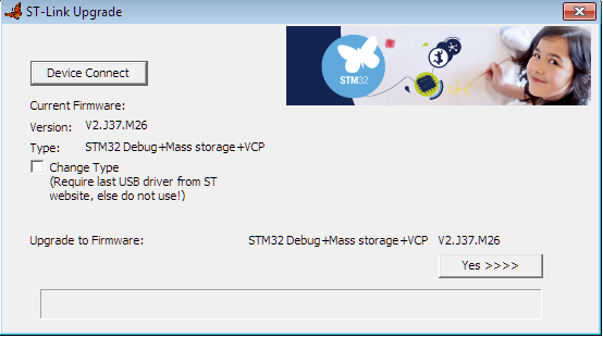

Managed to update STLink to V2.J37.M26 ( attached picture) as the flasher asked to.

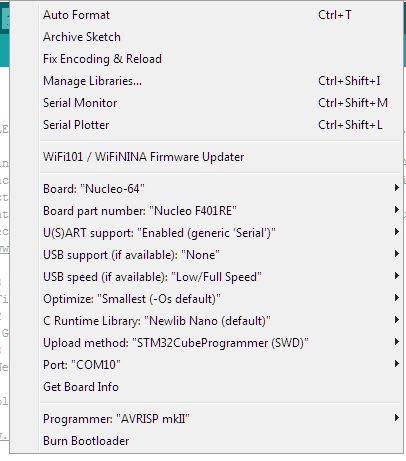

The settings i used to flash:
And then it seemed to be able to flash the Nucleo F401RE using STM32Cubeprogrammer(SWD) , the default program of blinking led light dissapeared.
However it doesn't seem the program runs. I did the default blink led sketch and nothing, and then tried to look at the serial monitor (for other programs with serial.println and also nothing.)

all seems right. I've tested with the latest STLink FW V2.J37.M26 and it works.

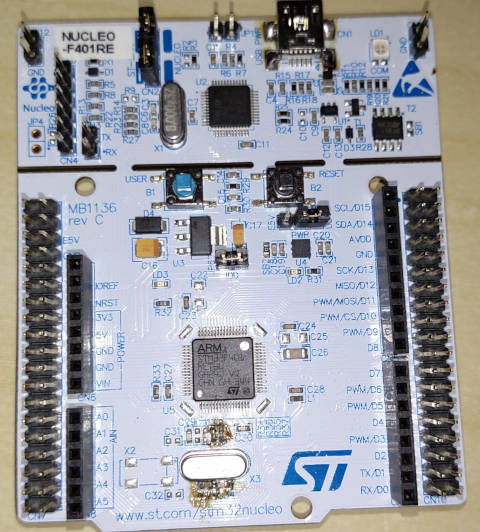

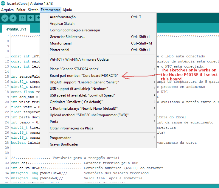

I have the same problem here, my Nucleo F401RE works perfectly on STM32 Cube IDE, but in Arduino, all the responses from IDE are ok, but the programs not run, even if I click on the reset button. However, if I select in the boards manager, the "Core Board F401RCT6" all the functions works, but the serial communication didn't work. The upload method that I'm using is STM Cube Programmer(SWD).
I will attach the images below.
Best regards.

For the Nucleo board use "Nucleo-64" and not "Generic STM32F4 series", then select "Nucleo F401RE"
What code are you trying to run?
pablomuro
Posts: 5
Joined: Wed Nov 18, 2020 1:27 pm
Re: Code doesn't seem to run Nucleo-F401RE
Post by pablomuro »
Thanks.
But if I set "Nucleo-64" and not "Generic STM32F4 series", then select "Nucleo F401RE", nothing works, the response of Arduino is ok, but the board didn't work.

The photo looks like an X3 crystal has been added, in that case the clock configuration must be changed in SystemClock_Config(void) defined in variant.cpp
pablomuro
Posts: 5
Post by pablomuro »
I added the 8MHz crystal and it's capacitors triyng to solve the problem, but this didn't help. I think that the problem is the clock configuration, becouse even if I use the clock from the st-link(default source clock), the results are the same. I will try to do that you recomended and post the results here.

Since the external 8MHz signal from the STLink has been replaced by an 8MHz crystal, the internal oscillator must be active and not bypassed. Therefore I think you must replace the line:
  RCC_OscInitStruct.HSEState = RCC_HSE_BYPASS;
with
RCC_OscInitStruct.HSEState = RCC_HSE_ON;
