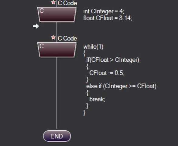

Flowcode gives you the "C", so the transition from visual to C should be an easy transition... just a paradigm shift.
ArduinoIDE is deceptively simple: most novice programmers go wrong because their introduction is via YouTube and that fries their brains with useless methodology. Rather, one simply needs to envision a program in Arduino as a 5-step process:

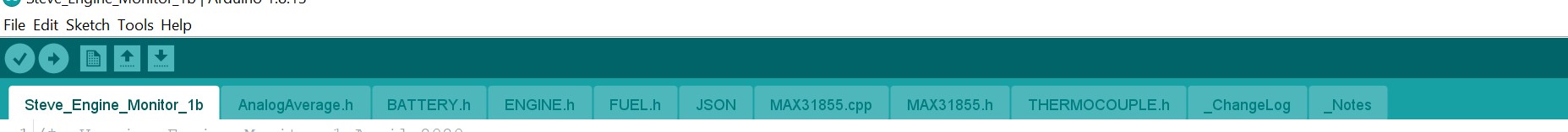

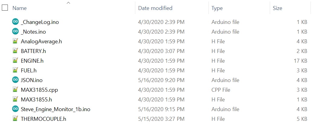

Engine Monitor.jpg (45.73 KiB) Viewed 5909 times
Section #1
#include "./AnalogAverage.h"        // Matrix summations
#include "./BATTERY.h"              // Voltage and Current
#include "./THERMOCOUPLE.h"         // Exhaust Gas temps left and right
#include "./ENGINE.h"               // Coolent temp, Front cyl temp, Rear cyl temp, oil temp, oil pressure
#include "./FUEL.h"                   // Fuel tank level
Section #2
// Type Variable Declarations for the main sketch tab
float temp        =  0.00;
Section #3
  // analogReference(EXTERNAL) ;    // A precision 5.00 Volt source OR other precision source
  analogReference(DEFAULT) ;
  Serial.println() ;
  // pins defined in THERMOCOUPLE.h
  pinMode(addr_0, OUTPUT); pinMode(addr_1, OUTPUT); pinMode(addr_2, OUTPUT); pinMode(addr_3, OUTPUT);
  digitalWrite(addr_0, LOW); digitalWrite(addr_1, LOW); digitalWrite(addr_2, LOW); digitalWrite(addr_3, LOW);
  delay(50);
Section #4
    analog_0();           // A0  Water temperature
    analog_1();           // A1  Oil temperature
    analog_2();           // A2  Oil Pressure
    analog_10();          // A10 Amps measured
    analog_12();          // A12 Battery voltage measured
    analog_15();          // A15 Fuel pressure
    thermo_0();           //     Exhaust Gas left
    thermo_1();           // To be determined   ... un-comment function in JSON tab
    thermo_2();           // To be determined
    thermo_3();           // To be determined
    thermo_4();           // To be determined
    thermo_5();           // To be determined
    thermo_6();           // To be determined
    thermo_7();           // To be determined
    thermo_8();           // To be determined
    thermo_9();           // To be determined
    thermo_10();          // To be determined
    thermo_11();          // To be determined
    delay(5000);
/*  thermo_12();           // To be determined
    thermo_13();           // To be determined
    thermo_14();           // To be determined
    thermo_15();           // To be determined
Section #5 Now, we write matching code for functions in the tabs, grouping if we desire. Because I often publish my silly little projects, I choose to "encapsulate" libraries within my code to make it easier for readers to get a project downloaded and working.

Example Tab: THERMOCOUPLE.h
#include "./MAX31855.h"              // Local (embedded) library
int thermoDO    = 51;                // SPI Data Out
int thermoCS_1  = 52;                // first EGT thermocouple amp Chip Select
int thermoCLK   = 53;                // common SPI clock to both 31855s
int thermoCS_2  = 50;                // second EGT thermocouple amp Chip Select used in Europa design
int8_t addr_0   = 36;               // 2^0    Addressline 0 going to analog mux
int8_t addr_1   = 34;               // 2^1    Addressline 1 going to analog mux
int8_t addr_2   = 32;               // 2^2    Addressline 2 going to analog mux
int8_t addr_3   = 30;               // 2^3    Addressline 3 going to analog mux

List of files with extensions:
Arduino handles the ".h/.cpp" and ".ino" differently: ".ino" files are concatenated to the main_sketch".ino" before feeding to the preprocessor. This is done to facilitate automatic function prototyping.
Good luck,
https://www.hackster.io/rayburne/projects
