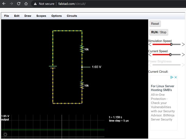

I strongly suggest you prototype your DC components using an online circuit simulator, for example:
http://falstad.com/circuit/
Doing the virtual design ensures you understand what the software is suppose to accomplish and is a valuable tool for future projects. Because you are working at 3.3Volts instead of 5Volts, some results may take a little thinking to understand especially when dealing with active semiconductor devices.
$ 1 0.000005 10.20027730826997 63 10 62
v 112 368 112 48 0 0 40 3.3 0 0 0.5
w 112 48 240 48 0
r 240 48 240 208 0 10000
r 240 208 240 368 0 10000
w 112 368 240 368 0
O 240 208 304 208 1 0
o 5 64 0 4098 5 0.1 0 1
Basic Voltage Divider.jpg (37.64 KiB) Viewed 3767 times
