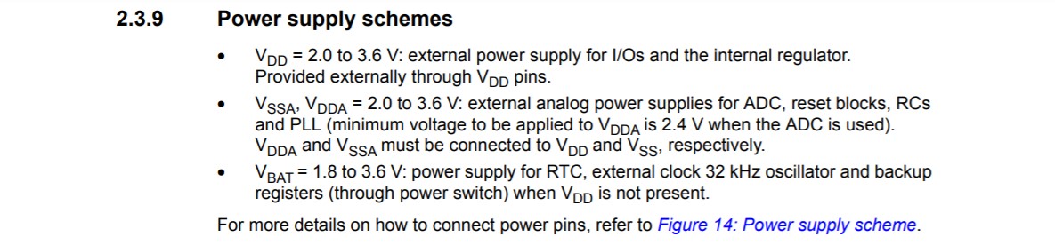

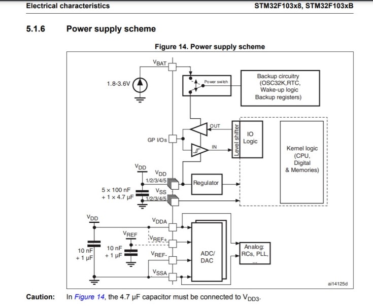

Re: SPI Remaping and I2C
sigi wrote: Tue Sep 29, 2020 5:47 am I use the internal RTC BUT I do not know how to use the VBat pin properly, it just do not work, I try with diodes etc and nothing work.
Black Pill PS scheme.jpg (67.5 KiB) Viewed 7594 times
sigi wrote: Tue Sep 29, 2020 5:47 am ... but u can not use all of its potential , I mean see this SPI problem I just want to use all the ADCs, a SPI screen, a NFR... It is for a RC unit to control my telescope and anything in the future more properly...
I know of no SPI "problem" or any serious issues. Are you referring to the "board" or to the uC?
