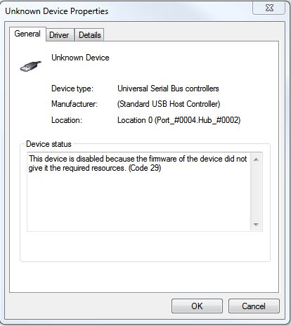

The issue is that no matter what I do the native USB will not work and I'm "loosing" two analog inputs PA8 and PA9.

Resource from Device manage
USB STM32.JPG (35.9 KiB) Viewed 3584 times

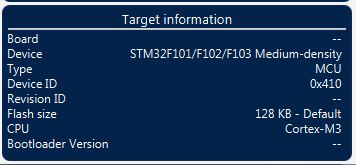

Picture of info from STM32cube programmer

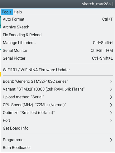

ARDUINO IDE configuration with working serial but no USB

for "bluepill", generally the board is "generic stm32f103c series" and variant is "stm32f103c8 (20k ram 64k flash)
menu
menu
usb-serial is a default in the built and is accessed as Serial. so you could do Serial.print("hello world"); etc
c8 , cb is the main working configuration.

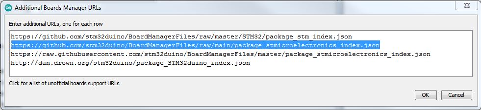

First I added " https://github.com/stm32duino/BoardMana ... index.json" in the "preferences" in Arduino.
Additional URL for boardmananger
Board Manager url.JPG (54.85 KiB) Viewed 3541 times

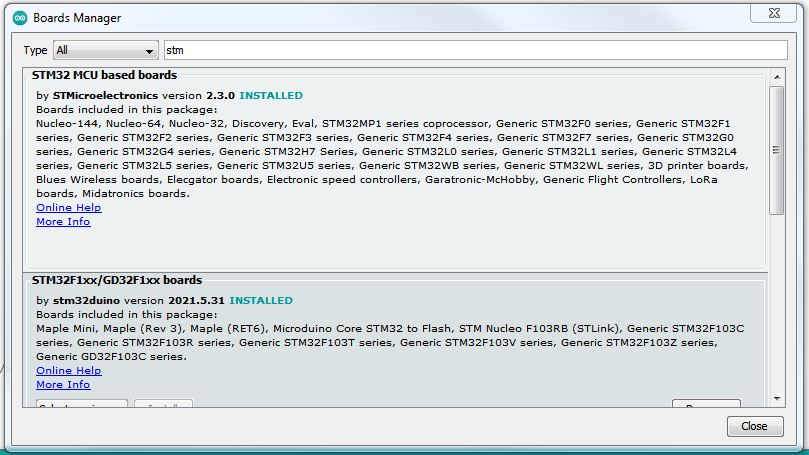

Then I installed the STMicroelectronics definitions in Arduino.
Installation in  Arduino Boardmanager
Board mananger.JPG (85.66 KiB) Viewed 3541 times

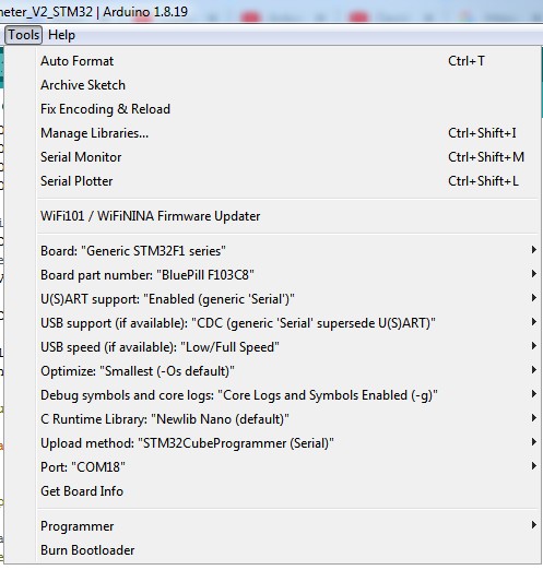

Here is the configuration I used to do the upload and get the USB to work.
Arduino configuration for board and programming
STM working but with USB.jpg (62.34 KiB) Viewed 3541 times
