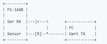

I faced the same problem. I am trying to implement this scheme but I am not able to configure the communication to work. Would you share how you defined Half Duplex communication?
https://github.com/betaflight/betafligh ... -telemetry
Screenshot 2022-07-28 120218.png (4.07 KiB) Viewed 5487 times
