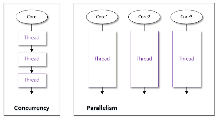

Nice to meet you. I want to use 'Thread' function.
Q1) Is 'Thread' function possible in 'STM32F103C8T6'?
Q2) Is there any way to do it?
- 'STM32Duino' example file or source code is required.
help. I need your help.
by GonzoG » Wed Jun 28, 2023 9:41 pm
@myksj1105
Same thing. Parallel threads can be achieved only on multi core MCUs.
Concurrent threads can be achieved using RTOS. There is a FreeRTOS for STM32duino: https://github.com/stm32duino/STM32FreeRTOS
But concurrent multithreading should be used only if there is no other way. Jumping between thread is time and resource consuming.

1. 'STM32F103C8T6' means that there is no 'thread' due to hardware characteristics.
2. If so, is there a 'thread'(Parallelism Thread) in the 'F4' chip?
it depends on your definition of "thread".
as the chip has only one execution unit (cpu or core), true concurrency (aka multi-thread execution) is not possible.
but that's not the end of the world: if you run multiple tasks fast enough, you can create the perception of "concurrency".
one way to achieve that is to use an OS. many different OSs exist for that, with varying degrees of complexity.
The simplest would be to run them serially - assuming that they are individually short enough.
