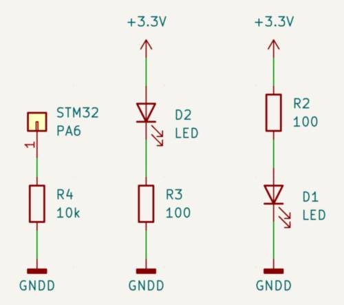

But the 100 ohm resistor is not connected to the ADC pin, only to V3 or another GPIO.

alexanderpruss wrote: Mon Jul 22, 2024 5:54 pm But the 100 ohm resistor is not connected to the ADC pin, only to V3 or another GPIO.
Learn to describe your problem correctly, so everyone has the same understanding!
From your start posting
alexanderpruss wrote: Fri Jul 19, 2024 3:17 pm When I put a standard red LED with a 100ohm resistor ... (or just between ground and V3) on my black pill, and I connect PA6 to ground with a 10K resistor ...
it can be this:
